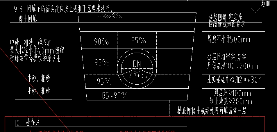

  • 挖土方深,回填土深,管(基)坑回填砂深度多少,預埋管道0.6,dn100管
    回填土挖土方
    你好。挖土深度=0.6+1+壁厚*2+0.1或0.2
    回填土深度=0.6-0.5=0.1
    回填砂深度=0.5+1+壁厚*2+0.1或0.2
